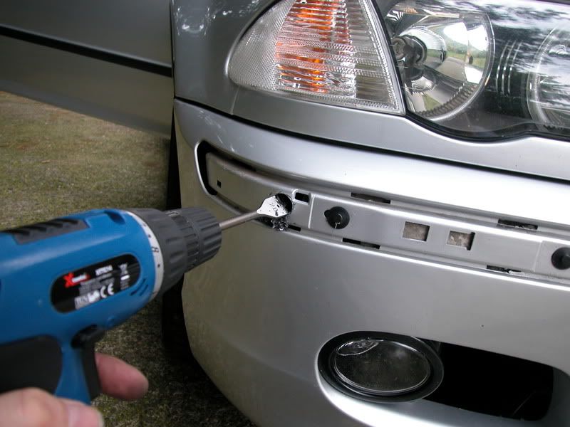

spent the last couple of hours slotting wires through things and drilling my bumpers (worrying!!)

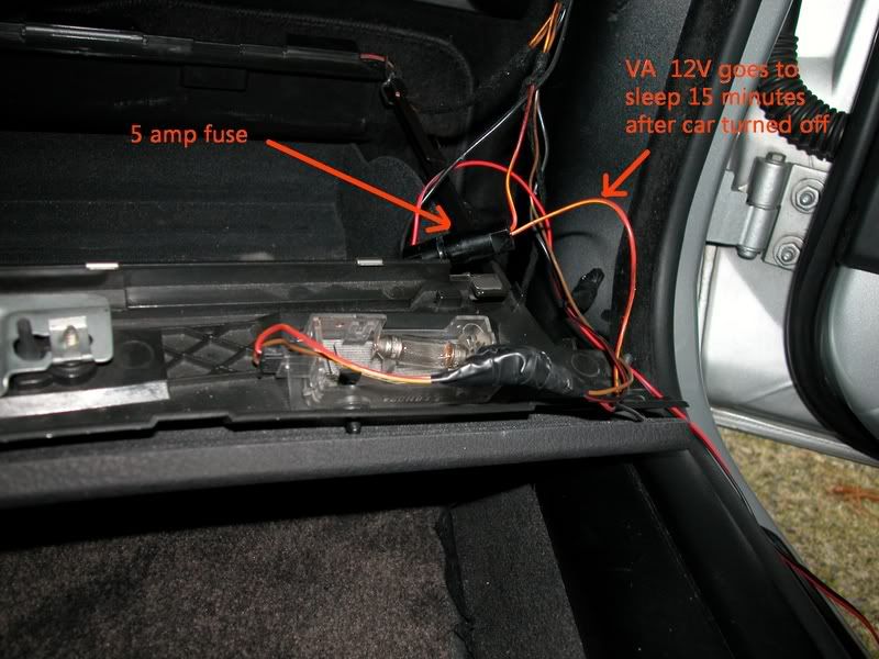

using red/yellow 12V (VA) goes to sleep 15 minutes approx after car turned off mainly because its more accessible than ign pos 1 kl15 and 5 amp fuse (probably be better with smaller).

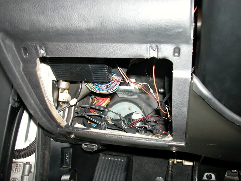

control box positioned far rh side under gm control unit
drilled bumper....ouch!

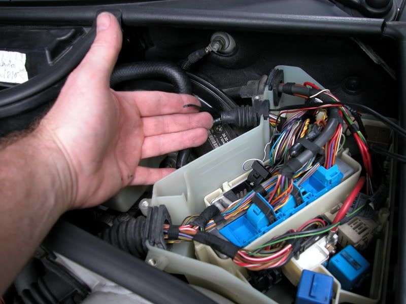

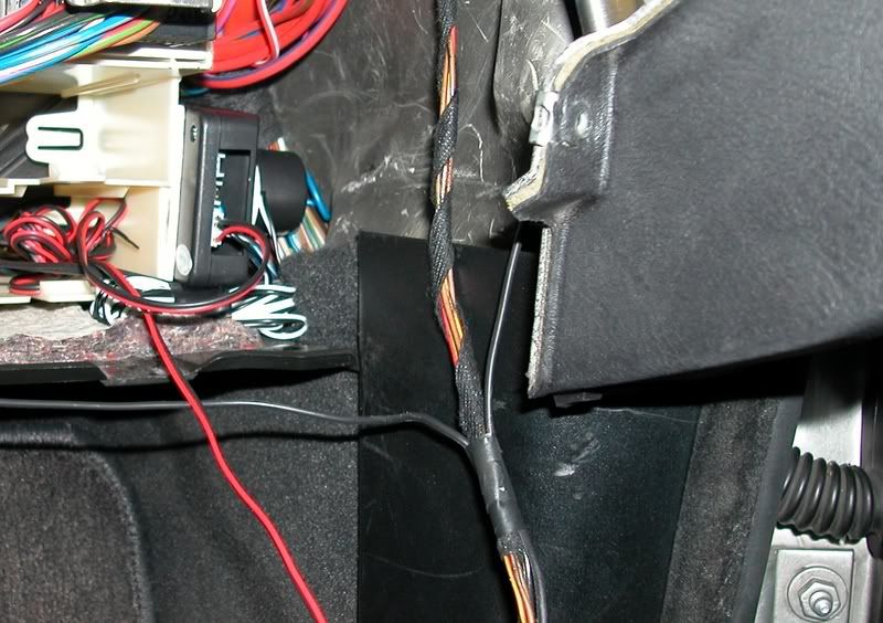

routed wires through baulkhead
into dde box and through gromet

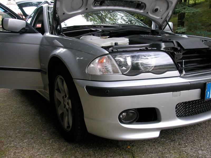

final result front bumper ..
will silicone sensors in later
