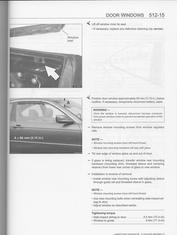

Hi. I've been trying to figure out how to remove the thin rubber molding that fits around the rear quarter windows of my 2002 330i sedan. It's #7 in the following diagram:
http://="http://www.realoem.com/bmw/...3&hg=51&fg=05"
I've been told that the rubber seal that fits around the top and side of the rear doors and the vertical trim piece that covers the thin pillar between the quarter window and window of the rear door needs to come off to access that seal. I was wondering if you could tell me if the manual shows how to remove those pieces. If you could post those instructions, it would be great, but even just letting me know if the manual shows these steps would be helpful because I would be willing to buy it myself. Thanks!
Sorry for my delay, seems I did not subscribe to this thread...

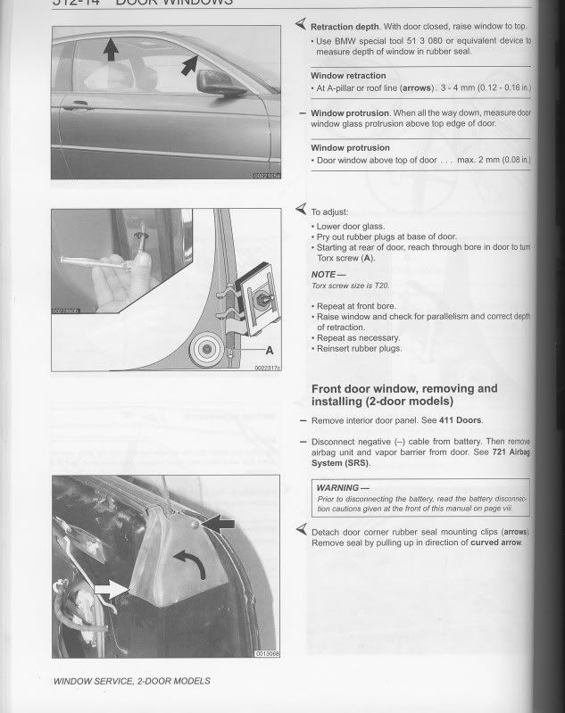

Anyway, Joseph, the Bentley manual that I have is for model years 1999 to 2001. Your 2002 Coupe (I assume) is not covered, however, the following is what Bentley recomends as far as the rear window is concerned in '99 to '01 Coupes:
