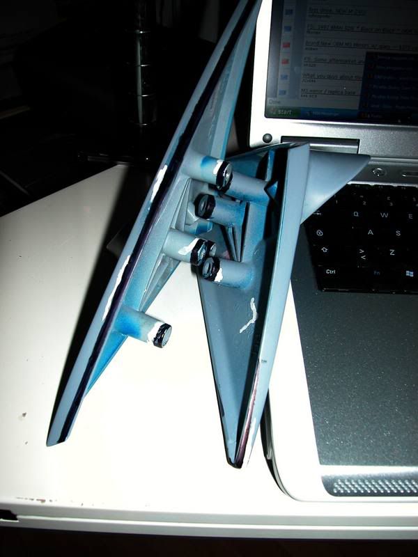

the inspiration
baseplate adaptation sorted thanks to
http://www.rogueengineering.com/Merc..._Code=E46M3MIR
baseplates marked up
ground bases
outline of new mirror base (green area needs cutting away)

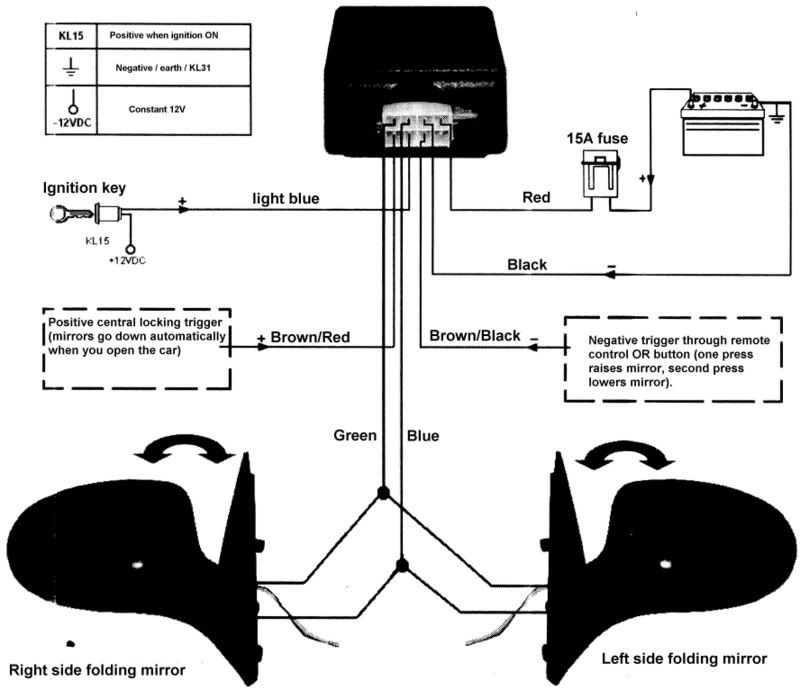

aftermarket module instructions
my car has no memory seats so needed white backed armrest switch which has 2 sockets in the back with an additional pin for the autofold button (see wiring diagram) its a straight swap with the original

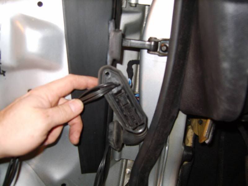

new wires passing into door
......taped to screwdriver and pulled through

wiring diagram
