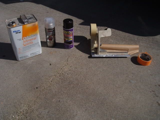

Tools : VHT NITE SHADES
Mineral Strip/Paint Thinner
Clear Coat ( i used high heat engine enamel)

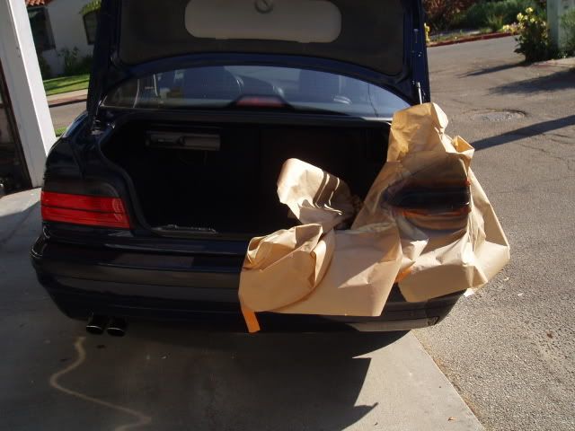

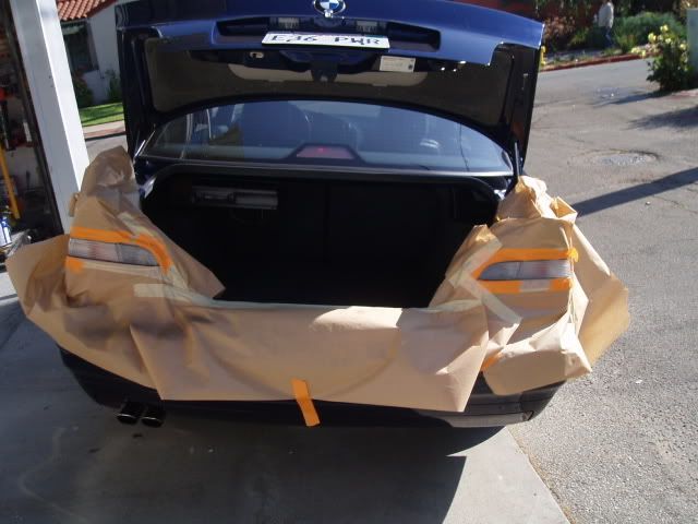

1. Start to tape off everything ( i didnt take the taillights off the car)
make sure you get as close as possible and do a good job. it will look like crap in the end of you dont take your time.

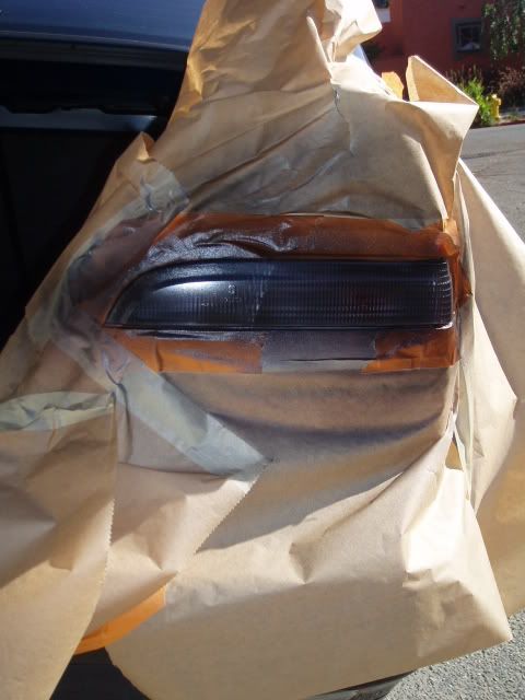

3. Apply light coats of VHT nite shades(wait a good 5-10min between each coat). Keep adding coats until you have darkness you like.
(my uncle giving it a shot.... note: old man arm)
